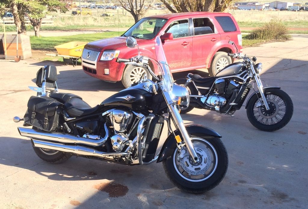

I recently purchased an '05 V2K with the windshield and saddlebags already attached. However, the windshield seems like it isn't doing much and I realize it is the lack of angle on it. My question is what do you recommend to angle the shield better and how much should I go?
I'll attach a pic. It's not great but it is unfortunately the only one I have at the moment. I can take more later. I'll also provide a link to the photo bucket so you can zoom in more if needed, Thanks!
http://s1241.photobucket.com/user/repickrel/media/87badd22-3eed-43c9-a4aa-f74b174f776a.jpg.html

That all depends on you. You basically have to adjust to your liking. Are you sure you just don't need a set of lowers?

Nope, not sure at all. I've never had a windshield on a bike till now. It seems like the wind overall is heavy on me, not just buffeting my head around. Are lowers typically the fix?

It looks like it does sit up too straight. Angle it back at the same angle as the front forks and set the top of the shield at or just below your nose level.
To see if you need lowers hold your arm across your lower chest riding down the road at speed and see if it reduces the wind on you. If so you need lowers.

That's a Switchblade shield system. I don't know how you think you are going to adjust the angle? The lowers fix the issue.

I messed with windshield angle and while some slight improvements were had, the main problem isn't the windshield. The main problem is wind under the windshield, up your legs, around the tank.
Don't believe it? Go for a ride and when the buffeting starts just put your left arm horizontally across your chest, just below your man boobs. Play around with the position a bit and you will soon see it's the wind from down low that's the problem.
Set the windshield so that you can just see over the top in normal driving, but lowers are the key

I have a switchblade that I use every once in awhile.
when I bought it, I got the lowers at the same time.
Out of curiosity, I've tried the windshield with and without the lowers.
RedDog is correct. The lowers will cut the buffeting to almost zero. Without the lowers, it seemed like the wind was actually being channeled into me.

I have a switchblade too. There is a small range of adjustment on it but only up and down really. National Cycle makes lowers for the V2k. I would try that. Like someone mentioned, while riding put your left hand down by the gas tank and see if it cuts the wind. If it does, you need lowers.

You guys are absolutely right. Putting my arm down around my stomach I can block the wind. I think I may attempt making my own lowers. I work for a sign company and we use lexan daily so we should have some scraps around. Just need to figure out mounting hardware.
