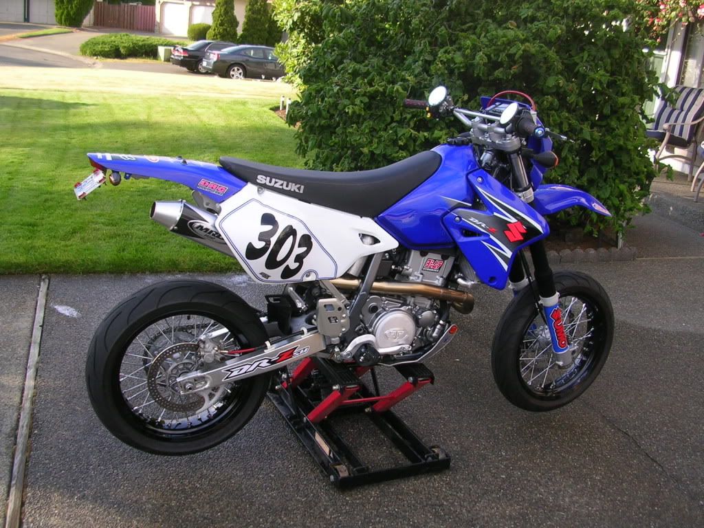

Does anybody use this style bike stand on their Vulcan? I used this style on my supermoto bikes and they worked great but I'm not sure what you guys use. I would like to take both wheels off my Classic LT for tire changes but if not at least have the ability to balance the bike securely and replace my front pulley and remove one wheel at a time. Pics of your bike stands would be appreciated.

It should. The frame of the VN900 should rest nicely on that jack and be able to be lifted up. Given that it IS a little bit heavier than a sportbike or dirtbike, you might secure it to the jack with some straps as well.

Yes, it will work. Two things;
1) make sure it's rated for more then 1000 lbs,
2) it will fit the frame nicely, but toward the front of the frame the engine hangs just below the frame rails. So, you might want to use a couple of small blocks (1" thick) on the lift under the frame rail so the engine is not sitting on the jack. I have used this style of jack without using the blocks and it's fine, but you only have 3 points of contact.

I have a Craftsman stand (which looks identical to the one picture). It holds my 2010 900 LT up fine. Getting it positioned is a bit of a pain.
It takes three chunks of 2x6 and 4 chunks of 2x4 (or hockey pucks).
The bike frame sits so low to the ground that I need to push the bike up on 2x6's to even come close to getting the jack under the frame. Then I put another 2x6 under the kick stand to get the bike a little more vertical.
Then I put the jack under the bike and position the 2x4 chunks on the jack rails where they will hit the frame. If not the lower portion of the motor will hit the jack. I pump and adjust until the bike is in the air.
A nuisance but I got the jack for $25 and it makes maintenance and washes so much easier.

Great info you guys and BeeKeep thanks for the tutorial description. That's exactly what I was wondering was the clearance and setup. Yes, that is a Craftsman under my bike pictured and it worked great...especially for washing the wheels etc. I just needed to know this will work on my Vulcan. Now I wish I didn't sell my jack with my bike but will find another soon. Thanks again.

The jack you have pictured is the same one that I have. Should be rated for 1500 lbs.

As said there is an issue with the engine hanging below the frame. I have bought a similar lift with the intention of welding some blocks in the right spot that match the frame but misses the engine. Haven't got around to doing it yet though.
I use a 2x4 block and a square block from a fence picket, I then put them under kick stand to bring bike vertical, just keep front tire point to left , front tire pointed right, the bike will fall over . the bike should be Vertical enough for you to slide jack under then you just need to put the Hockey pucks or 1x4 blocks under the frame , then lift
