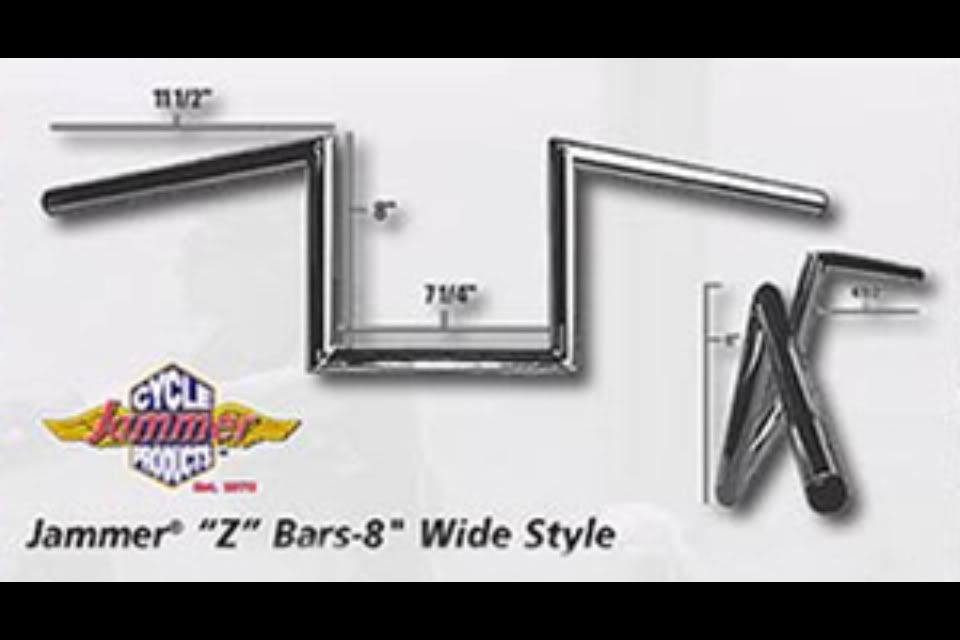

Will these work with the stock risers on a 900 custom?

First off. You would need Classic risers. Customs are welded to the bars.
i bought them off of a fellow forum member. they're getting mailed to me on Monday...

They will work fine then with the Classic risers and without cable swap. There are many posts on bars here.
i've read that you don't need a cable swap if you're changing the bars to 10" or less while using the stock risers from the classic.
i'm more concerned about the controls being ok and with my ISO Grips just wondering if i'll have enough room with the controls and the grips.

You'll be fine. Plenty of space. You have 11 1/2" to work with each side.
sweet. i was planning on ordering them anyway but i just wanted some reassurance. i will post picks up as son as i'm done.
thanx a bunch
