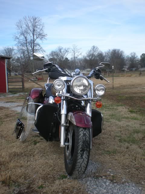

I added the Kawasaki quick release to my '09 Nomad. Quality product. Loved not having the shield for local riding.

Hi Nomad2010;
Yes, the KQR is not adjustable like the fixed windshield. Mine is stock height wise but I don't usually ride at night on the rain. Expect folks cut them down to fit their own requirements for height if necessary.
It certainly is easy to remove and replace and has a locking mechanism that keeps the honest people honest. Hardware is excellent quality, looks pretty good and of course fits perfectly.
So with this shield, quick release bags, and maybe. KQR sissybar, you can have a naked bike go to tourer or bagger in seconds if that's your thing.
