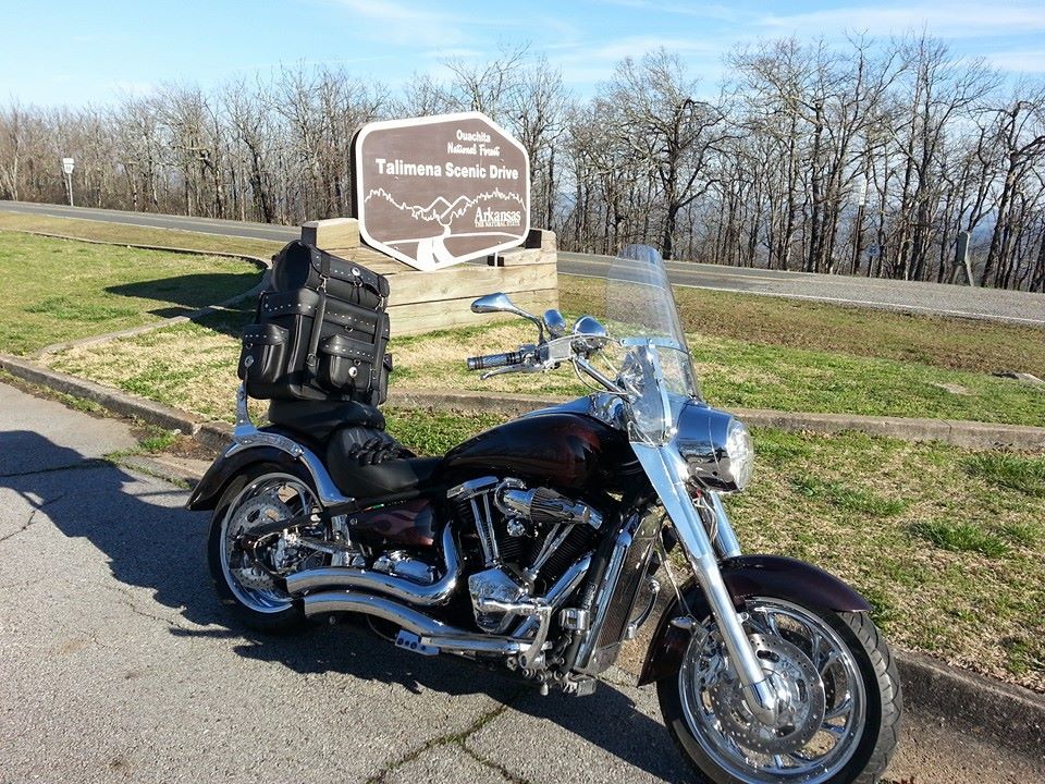

I have the Vulcan Classic. I had a National Cycle windshield but it was cracking so I got the OEM Kawasaki windshield but they don't sell the lowers now. I may try the ones posted here. The ones on the National windshield won't work.............:D

I just put a set of these on mine. If you loosen and move the upper shield mount as far as it will go on the front of the forks, you won't have to slot any holes, and they will bolt up correctly.
KAWASAKI VULCAN 1700 WINSHIELD LOWERS PART # 99994-0160
Worked great on my 2008 VN2000 Classic - NO Mods Necessary!
Got them On EBAY $50.00 !!

The ones for the 1700 worked great..........:D
Glad they worked out well. Did you have to notch them or not?

Yes, I took the original mounting straps off and used it as a guide and notched them slightly..............:D
There is a long chrome strip on each side that Kawi used to cover the slots of the windshield bracket. Mine were missing, but if you get rid of that you don't have to notch the new 1700 lowers. Since the lowers cover that area anyway, I see no need to keep them.
