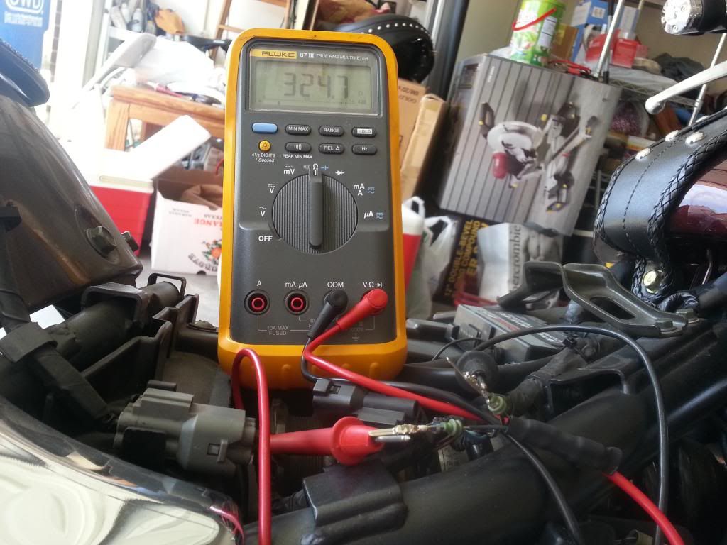

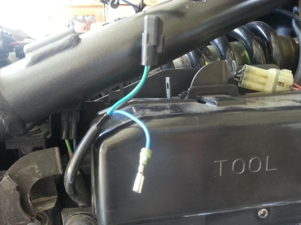

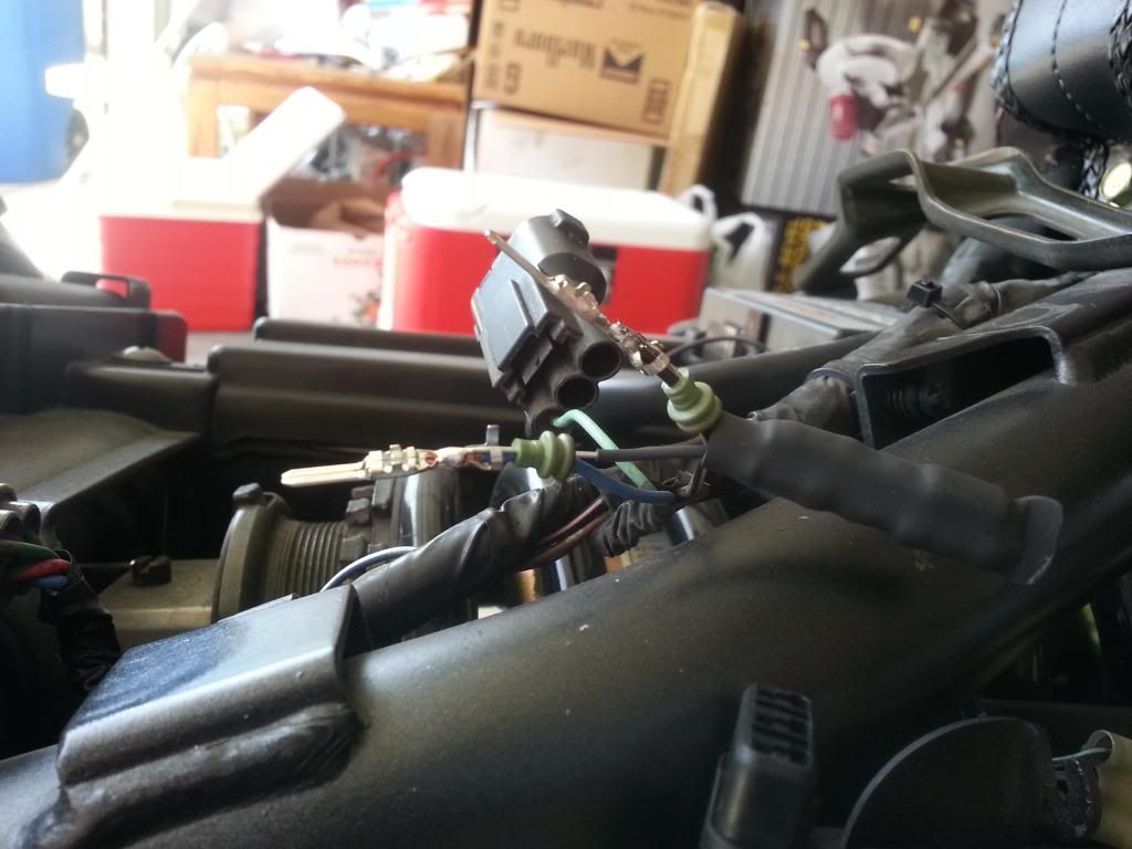

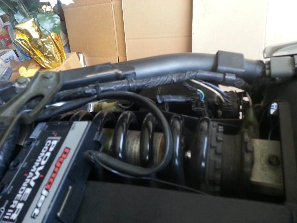

TB2000,
I've completed the mod. I rode for about 40 miles and I love it. I have an 04 so the 1st and 2nd made a big difference. My Freedom Pipes came in today. I will install it this weekend if the weather is not so cold.

I own the CM shop so I have million and million of parts in stock. You can also go to the local store and buy 1/2 watts 5% of 330 ohms + 100ohms + 2 ohms (or 1ohm + 1ohm) and wire them up in series then you should have 432 ohms. Even though the resistors said 5%, but they often read very close to their values. This is to trick the sensor so several ohms below or above 432ohms is still working fine. I would not worry about the tolerance. When I had mine wired up, it read exactly 432ohms with 5% tolerance resistors.
If you can't find the resistors let me know and I can make one and send them to you.
