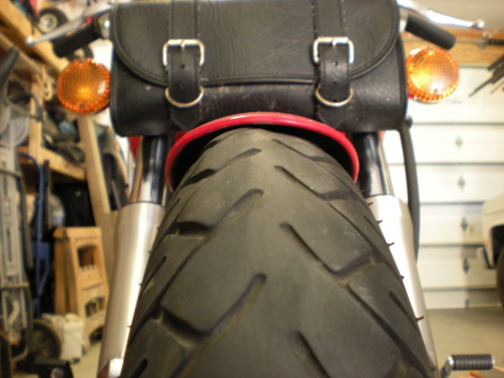

I had a real bad wobble a couple tires ago, tried a few remedies, reballance, dynabeads, steering head, alignments {front and back} nothing worked. Then with about 3000 miles on that tire, one day about 50 miles from home I noticed a small blister on the front tire, by the time I got home it had turned into this.
When they took the tire off it had delaminated nearly all the way around on the inside. New tire on, no more wobble, can coast to a stop with no hands {not that I do that}, smooth and straight.

HEY, that looks like my old Pirelli. HMMMMMM Maybe the nail didn't cause the problem in the first place.
