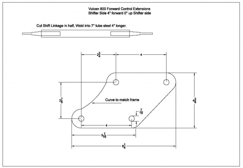

I tried to set these templates up the best I can as many people have been asking about how to make forward controls. These with minimal work you should be able to set up 3-6" forward and 0-1"up. If you are interested in the actual pdf that should print out very close to scale. hit me with an email at timb4302@gmail.com. I will be happy to email them to you, the file is too large to post here.

I am working on Autocad drawings with all dimensions, Hopefully have them posted as a pdf before the weekend!

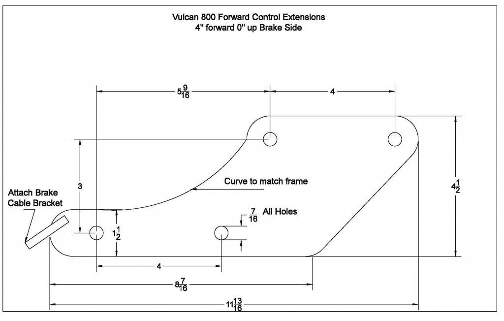

Default Shop Drawings with dimensions, 800 forward Controls
These are 4" forward, 0" rise forward control extension templates
Hope these Help!

Working on fabing a set of 5" controls using your template. Do you a template for the brake cable bracket? Was thinking I would leave the original bracket in place if I ever wanted return to the stock position.
Thanks again for all your help.

I had to cut and reposition it, otherwise it is in the way of the cable. I had an extra set of brackets that I had kept in case I want to go back to factory. You can find them pretty inexpensive.
