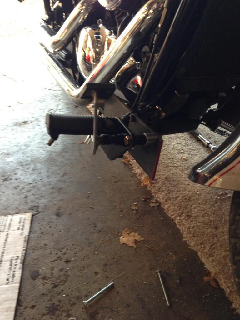

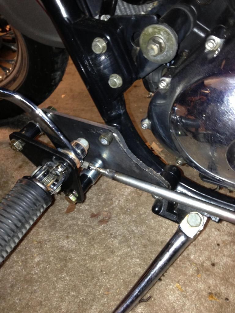

Rough pictures
Here is what i have so far, just trying to mock up the right size to feel most comfortable, I am 5'10" I have a 31" inseam. these are sitting at 4 inches forward and one inch out. I think i may back off to about 3- 3.5" to get the perfect fit.

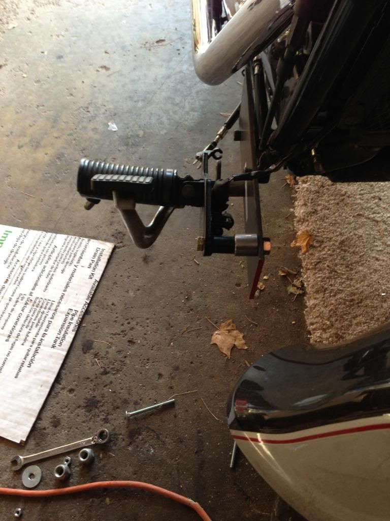

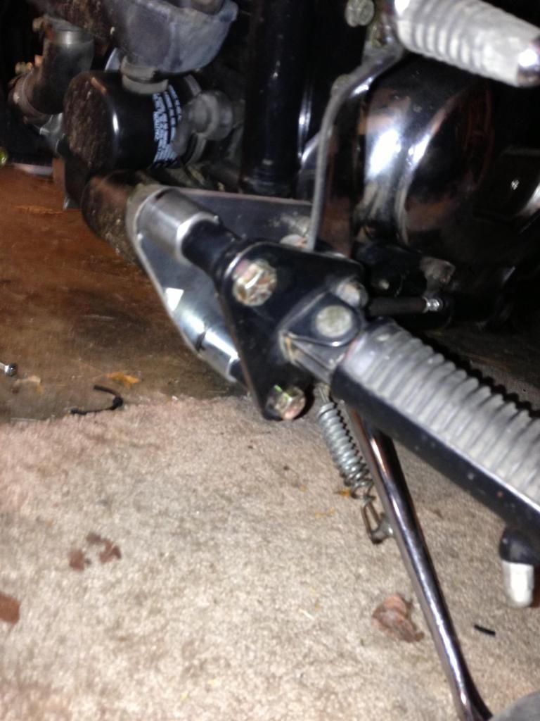

Updated Pictures of Forward Control Extensions
So I got these roughed in and actually got to go for a short ride, 30 degrees, so very short.... Very comfortable riding position! I love them, Need to clean them up and spray bomb them!
