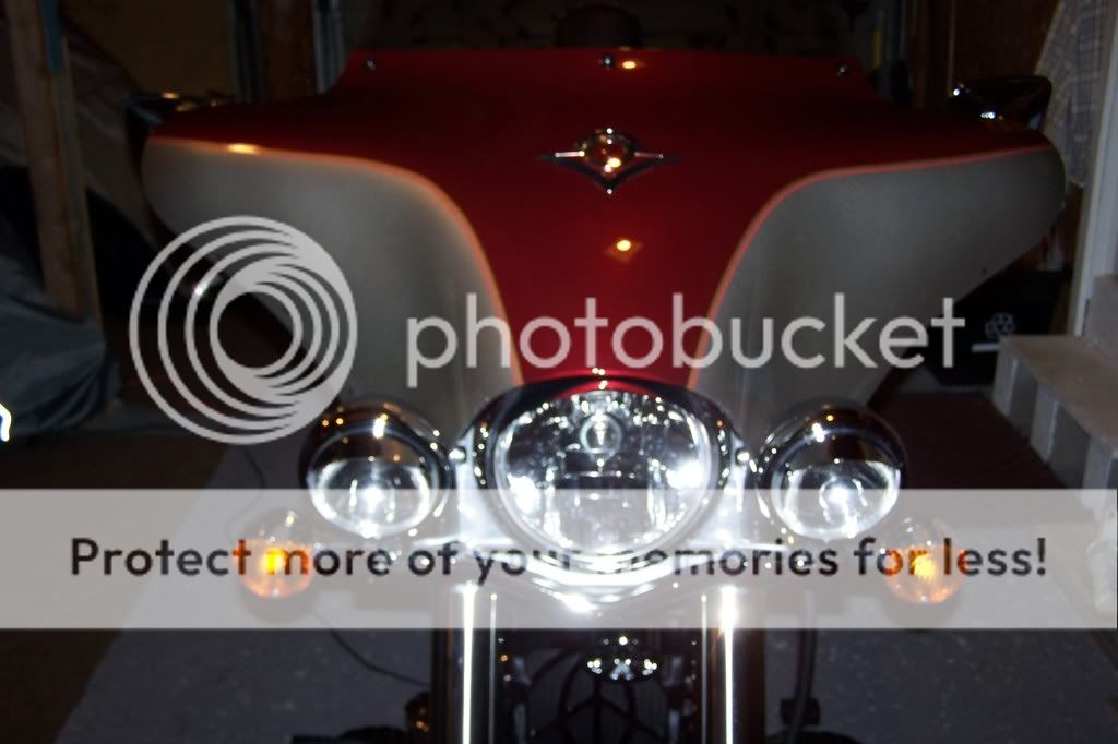

Thanks for the reply Sarge. I tried the washers but still didn't give me enough to get the light at the spot I wanted them. So I placed new holes in the bar about 1/2 over and a 1/4 forward. Now I have plenty of space to point them where I like and enough clearance so they won't rub the shield. Picked up a couple of chrome plugs that covewr the screws of a bathroom faucets to plug the old holes.
Now that's done the next mod will be to add the Vulcan emblem to the wing.
This picture is before doing the mod to the lightbar

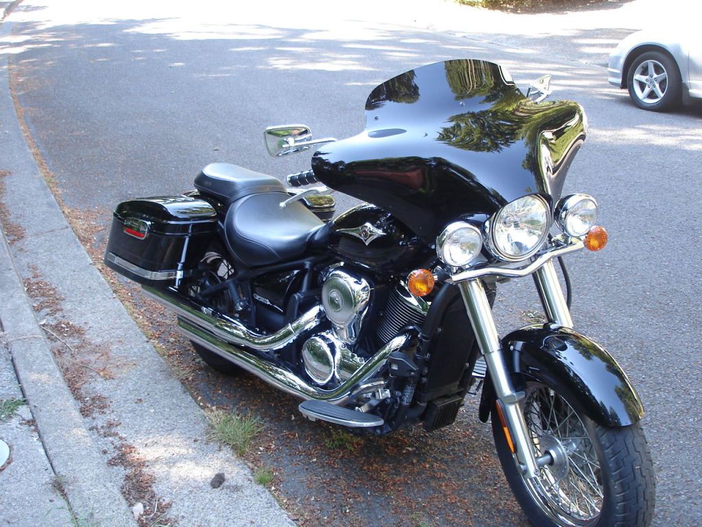

When I get chance and good light I will take close up picture of the new holes I drilled in my bar how much clearance I have between them and the wing. With the plugs I put in them you really have to look hard to see them and if you dont know you cannot tell the lights have been moved. With the new placement I don't have to worry about the lights hitting or rubbing at all.
As for the visibility, I have no issues with mine. I have a 9 inch windshield so I'm looking right over the top the windshield. The top half of my shield is back but does not hinder my visibility at all.

Here's a picture that shows to show what it looks like from where I sit.
And here's one taken while riding. The camera is mounted on top of my helmet so the point of view is higher. The top of the windshield comes to my upper lip/tip of nose area.
