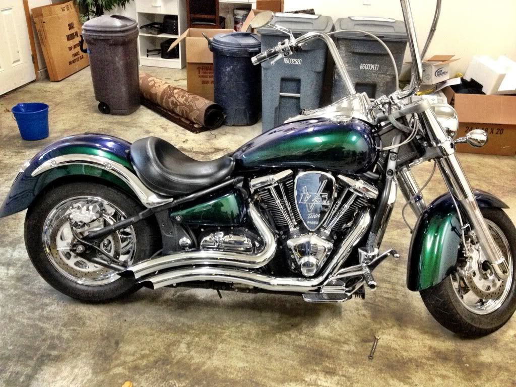

BigSarge is right, Barons is an awesome breather kit and is really kool when you listen to it sucking down some air, LOL.... Heres my BAK with added Skull Man!!
